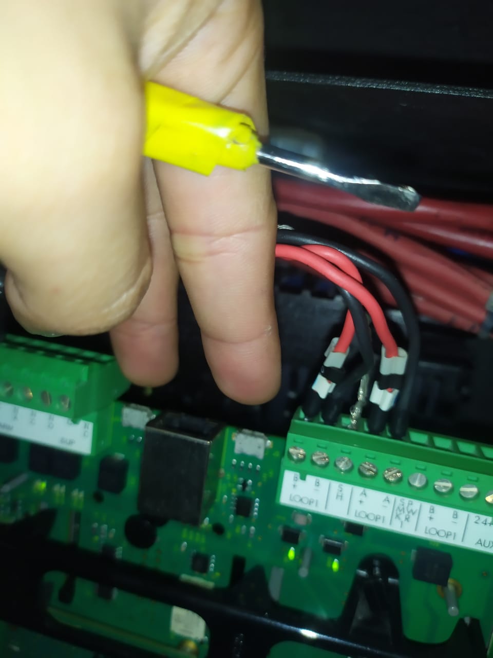

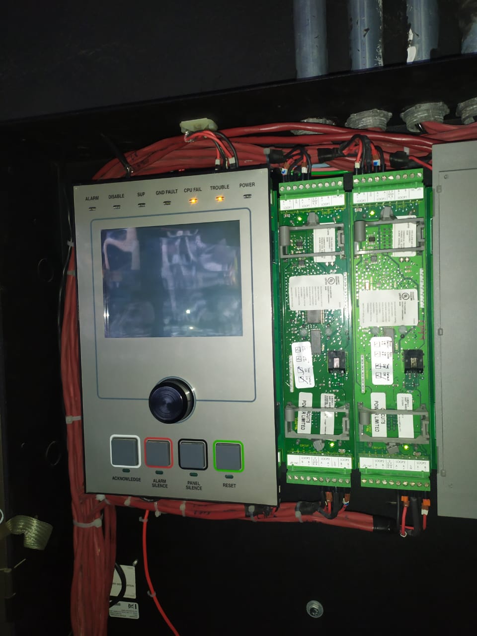

I have on my work's place an EST3X that was selled as new and had been discovered after a failure that wasnt true, was a showcase item. The failure happened when a new program was sent to the panels on the network (We have here an EST3 plus an 3ANN-CPU plus an EST3x). The other 2 panels received the new program normally but the EST3x failed on the process with no apparently reason (the new program that was sent was only different on timing for the rules). After the fail, 2 LEDs on the EST3X have been turned on: CPU Fail and Trouble (showed on the pics.)
I've tried all possible things since that, but with no sucess (Including all the related directly or indirectly things to EST3 in this forum). Edwards, through a partner hired by us, have tried to help, but i think that they dont realy cared about, so, wasnt a really good help. The only things they suggested was try cycling power and dismount everypart and try to send a program with the least quantity of items possible. (tried with no sucess too)

2. I've noticed that the EST3x pannels have 2 micro-USB connectors (can be seen on pic 2), that Edwards dont wanted to talk about to us. I'm think if that is something to upload some kind of BIOS to EST3x. Somebody has tried sucessfully to send something through that ports?

Sam, i cant get any comms with through rj11 serial port. I've tried a lot of things, cycling powers, cyclling with some buttons pressed, but still in that screen. When i try download anything or even make a version request, i get no answer from the ESt3x (timeout). I tried changing serial speeds, the adapter is fine cause i use it every week to some changes on programings on the working EST3 we have. I programed this ESt3x several times, she failed with apparently no reason on a download (the only change i've made was a timing for a rule, nithing else). Then she stuck on that screen and i cant make it go to Service Utility Mode...
