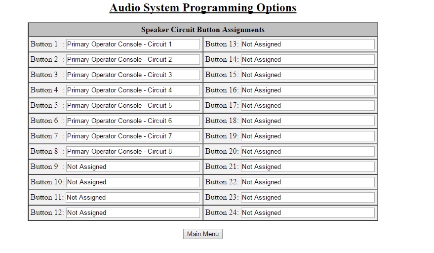

Is a 50 watt amp with one output.
Adding the 6 relay board will give you 4 evenly distributed speaker outputs
Adding the 50 watt board will make it a 100 watt panel and all 8 outputs will be available.
Both mount nicely in panel.

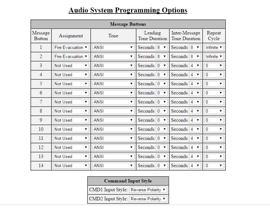

Connecting a notifier panel to the NFC via the ACS or 485 dataline will give you more control over which inputs from the FACP turn which speaker circuits on. the NFC will not send info back to the FACP with trouble status.
The easiest way to turn all the speakers on is to use CMD1 and the FACP's NAC circuit.

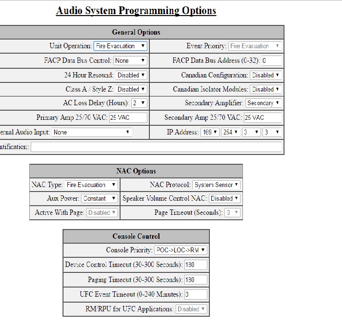

Web Browsing into the NFC to program.
change your computer to:
computer IP address: 169.254.3.5
computer Subnet mask: 255.255.0.0
panel http://169.254.3.3
Log In Password is 0000
before logging out check that the changes you made took.
log out so system can reboot, there will be three logouts
