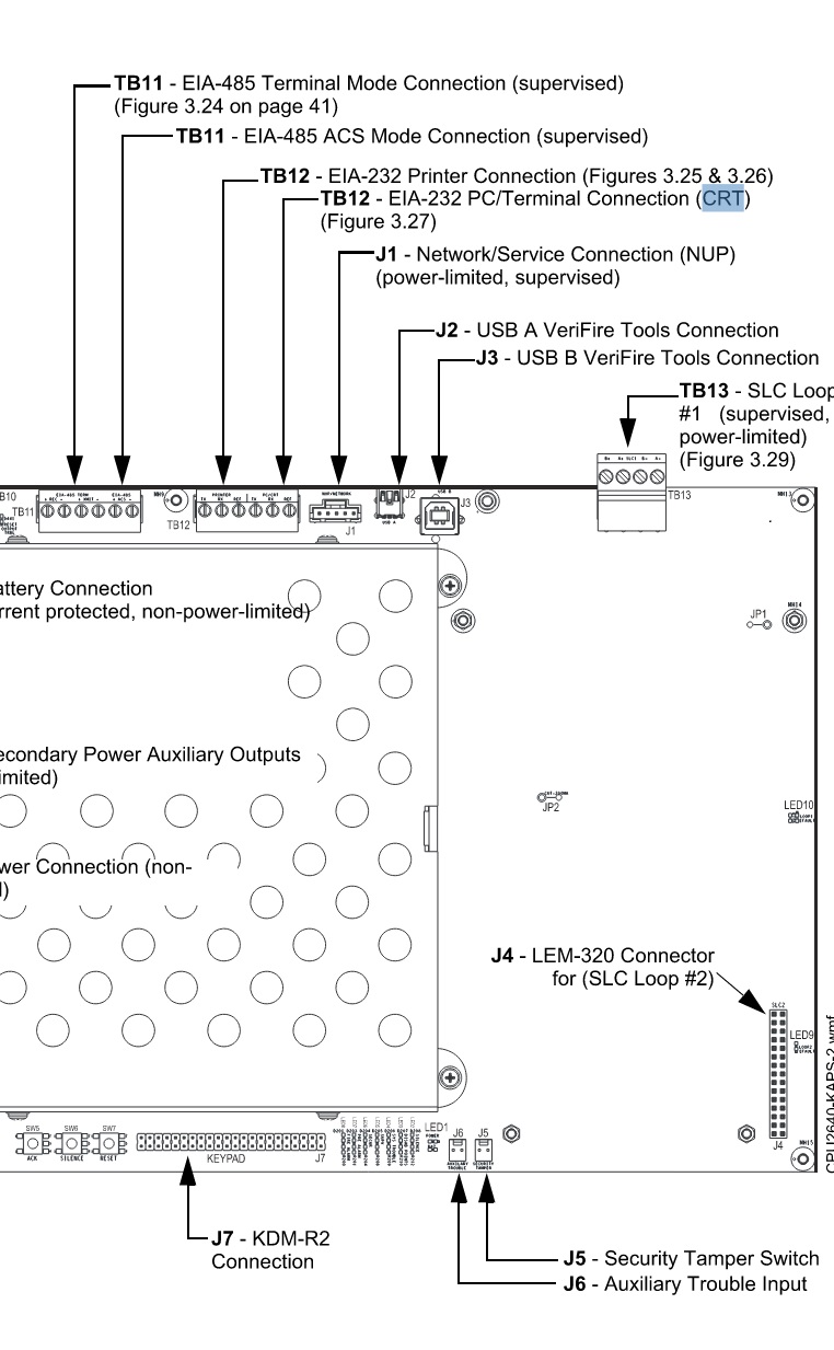

NFS2-3030 NFS2-640 has both USB and NUP to load panel

Also, if anything is wired into CRT terminal block (TB12 just left of NUP port). Press the enter key, 1 for programming, when prompted for the password enter "NOCRT" then enter. When done with programming, Don't forget to re-enable the CRT port by repeating the steps above using "CRT96" as the password. The EIA-CRT port and NUP port share a connection with the CPU. Both cannot be active at the same time. Ask how long it took to figure that out over the phone with Tech Support....

bouncer334 wrote: Fri Dec 09, 2022 11:47 pm Also, if anything is wired into CRT terminal block (TB12 just left of NUP port). Press the enter key, 1 for programming, when prompted for the password enter "NOCRT" then enter. When done with programming, Don't forget to re-enable the CRT port by repeating the steps above using "CRT96" as the password. The EIA-CRT port and NUP port share a connection with the CPU. Both cannot be active at the same time. Ask how long it took to figure that out over the phone with Tech Support....
