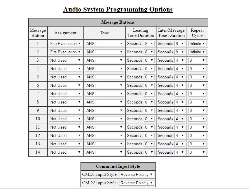

screen shots 1
screen shots 1

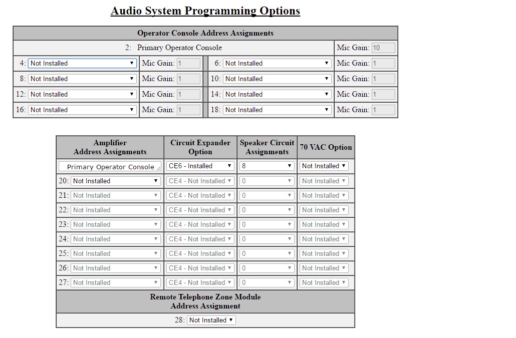

screen shots 2
screen shots 2

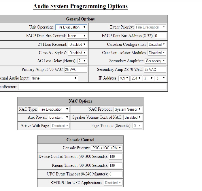

screen shots3
screen shots3

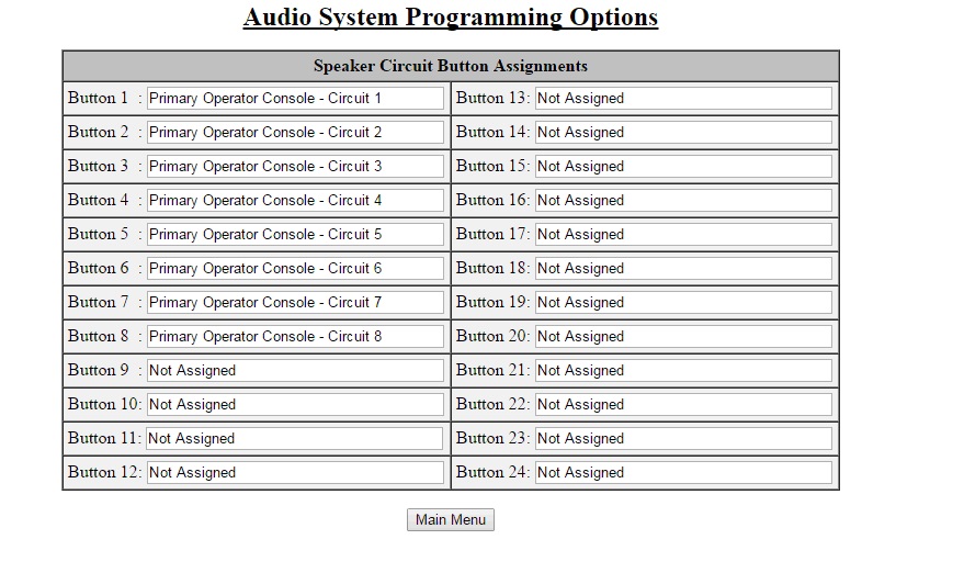

screen shots 4
screen shots 4
