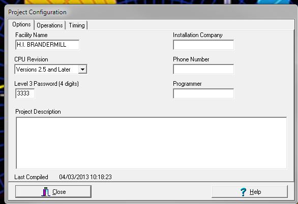

Have a QuickStart CPU v 2.5. Old CPU is v1.81, db v2.5. I retrieved the database from the old CPU, replaced CPU with the v2.5. When I try to dump the database in the new CPU I get a "Transfer Error" popup on the PC, after qs-cu reaches 100%. CPU shows Need Database. I am able to successfully use code loader so I don't think it's a hardware (PC or cable) problem. This has happened with 2 "new" CPUs now so I can't imagine it's the CPU either.

make sure you set the version correctly in the project configuration. If you uploaded from a 1.8 cpu and subsequently downloaded a 2.5 cpu without upgrading the database, it will cause problems. Also make sure all cpu's in the project are the same firmware version.

Just got off the phone with the area EST distributer and qs-cu v2.6 is needed.
